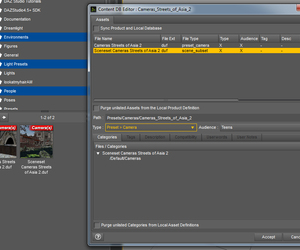

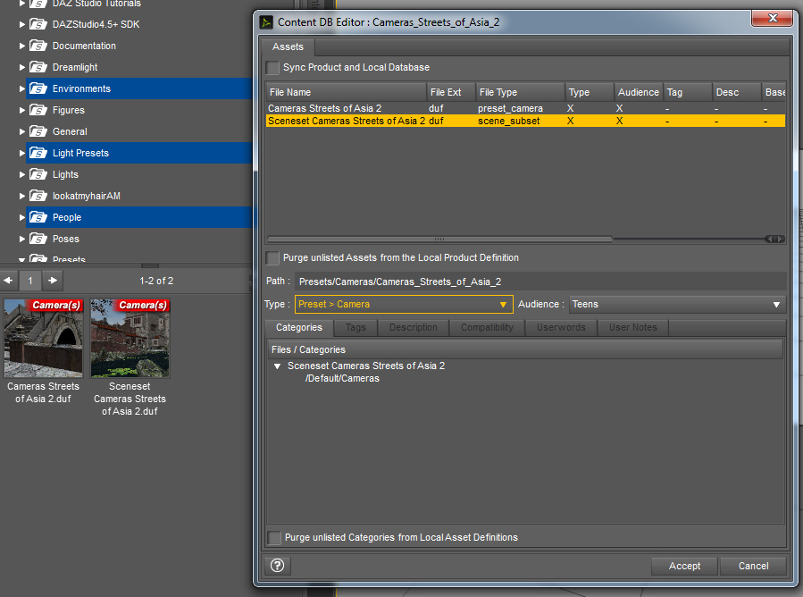

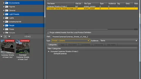

    Markus Ba: but in the camera folder there is now a green "SET"-Icon instead of a red "CAMERA"-Icon. Can i change this anyhow?
    Mario Busch: With the file visible in Content Library select Content DB Editor in the Panel Menu. This will open the Metadata editor. There you can select the file and change its Type and set the Category. In this case choose Type: Preset>Camera and set Files/Categories to the root /Default/Cameras/
    That is it. I hope this help you.

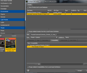

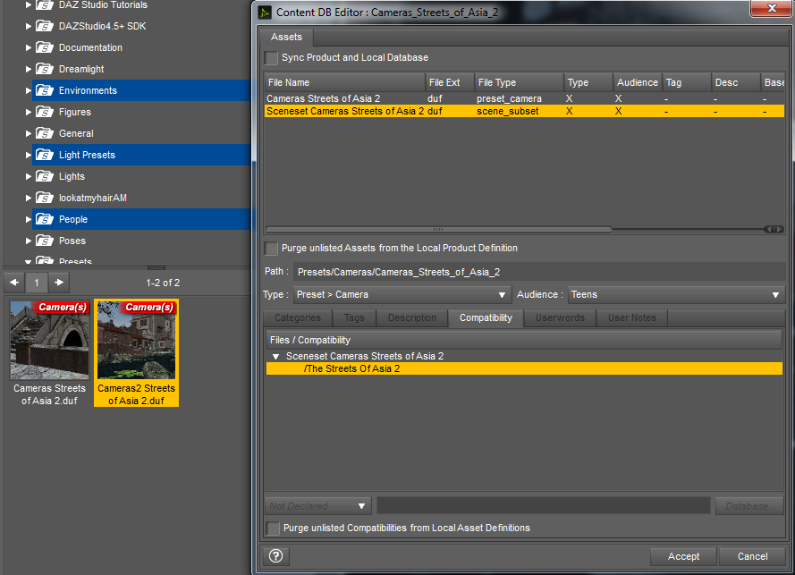

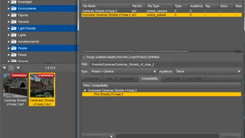

    Mario Busch: That's it. If you want, click in the Compatibility tab, select your file and right-click over. Choose "Add Compatibility to Selected File(s)". In the list search for Streets of Asia 2 and select it. Just select the Root, not any Sub-Compatibility. Now, when you have any prop of Street of Asia 2 selected in the Scene pane, you will get the Camera preset showing in the Smart Content pane in Cameras category.
    Markus Ba: thanks. I did so, but there is nothing in the SmartContent / Cameras - Tab when i have selected the Streets in the Scene-Folder
